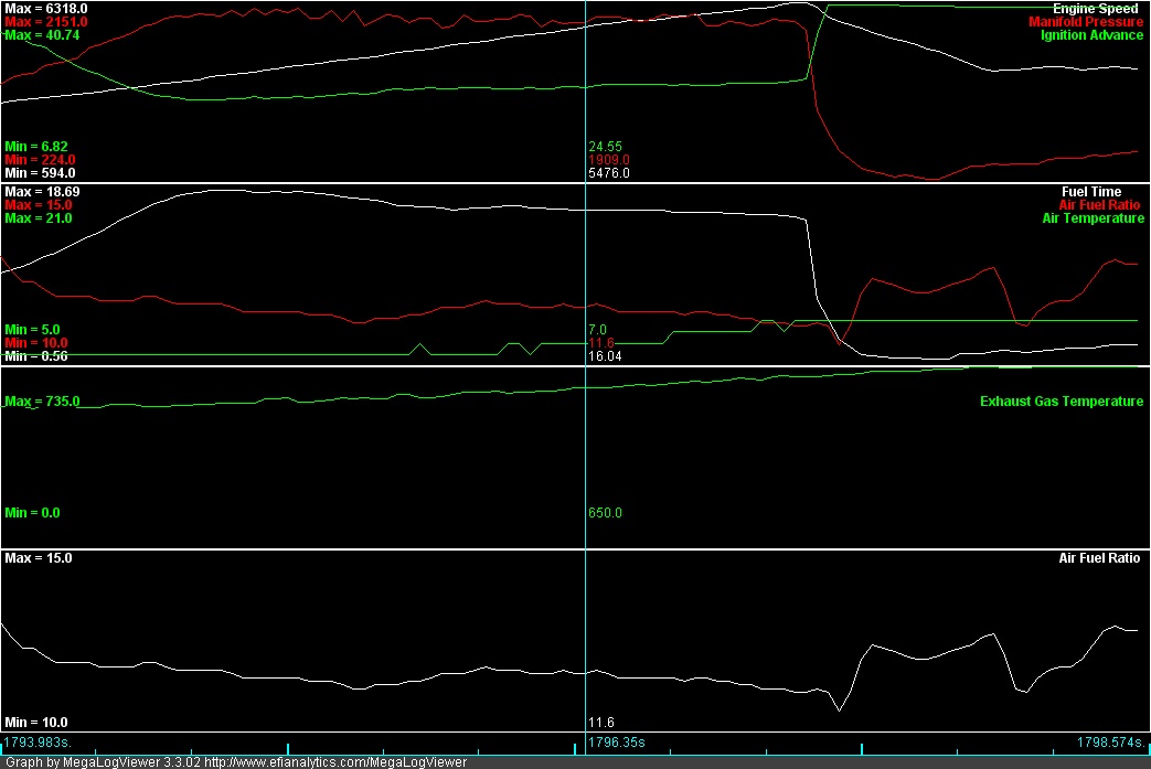

On the side of the MBC, a good one will hold boost just fine and they are simple cheap and reliable! Also EBC's can be irritating due to the clicking noise of the solenoid. But they can do cool things like throttle/rpm based boost control. What boost level are you planning on running? Here's my boost log with a turbosmart boost T. There is some fluctuation but its no great and the MAP measurement is made using an in plenum MAP sensor which is very accurate and responsive, you wouldn't notice it on a boost gauge.
