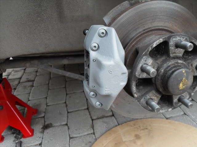

Mine are being powder coated and rebuilt as we speak, fingers crossed they will be with me on monday so I will post some pictures up.
I decided to use this company in the end www.porschecalipers.co.uk
