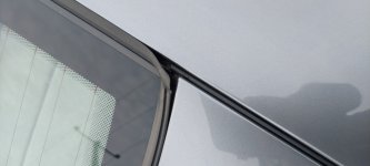

Hi everyone
Anyone know of a fix (preferably quick & cheap!) for the rear window seal starting to lift at the driver's side (RHD) bottom corner (as per photo)?
It seems to be reasonably common on 996s and always seems to be that corner for some reason. Thanks.

Yes, it is common on the early 996s. Porsche issued a bulletin to cover it. Yours looks a bit more serious though. Maybe clean it out underneath, and stick it down.

It's not actually a seal but a trim piece and once it starts it'll keep getting worse due to age.
You have to remove the entire rear glass window to fit a new one although you can get something generic that might squash in and stay in place.
